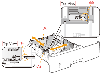

2
Slide the paper guides to the position of the size of the paper to be loaded.
While holding the lock release lever (A), adjust the guides.
Align the position of (B) with the size mark of the paper to be loaded.
When loading A6 paper in portrait orientation or A5 paper in landscape orientation
Slide the paper guide at the rear center toward you.

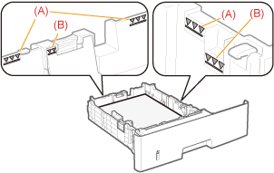

5
Make sure that the paper stack does not exceed the load limit mark lines (A) or (B).
(A):
Paper larger than A5 or Statement
(B):
A6 paper
Be sure that the paper stack does not exceed the load limit mark lines. If the paper stack exceeds the load limit mark lines, this may result in misfeeds.
