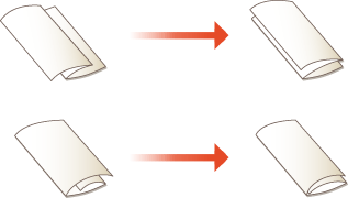

Adjusting the Paper Folding Position
You can adjust the folding positions of the paper, such as when performing Z-fold or C-fold using the optional paper folding unit.
