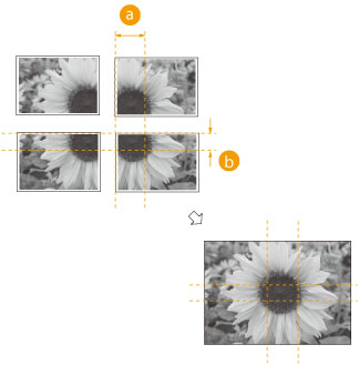

The copied sheets have areas where the images overlap ( and ), as indicated in the diagram below. When joining the sheets together, cut these areas to an appropriate width and glue them together.
The width of the areas where the images overlap differs according to the copy ratio and paper size.
