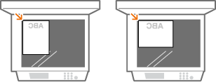

Place the original face down on the platen glass.
Align the corner of the original with the top-left corner of the platen glass.
When copying 2-sided original, place the original so that the top and the bottom are properly positioned, as shown in the illustration below.

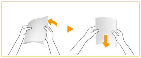

Fan the original stack and align the edges.
Fan the original stack in small batches, and align the edges by lightly tapping the stack on a flat surface a few times.
