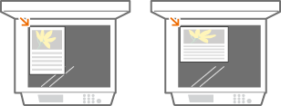

Place the original in a proper orientation as shown in the illustrations below.
![]() Originals of heavy or thin paper cannot be placed in the feeder. Place the original on the platen glass. In this case, place the original in a proper orientation as shown in the illustrations below.
![]() When making 2-sided copies, functions of some settings such as the paper size and type are limited. For more information, see Specifications.
