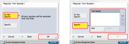

15.
Set exception port number → press [OK] → [OK].
To specify all port numbers as exception: Press [Do Not Specify].
To specify port number individually: Press [Specify] → press [Add] and enter port number → press [OK].
IMPORTANT
You can register up to 16 port numbers for IPv4 addresses, IPv4 ranges, or IPv4 address prefixes.
You can register 50 port numbers for one port number setting.
