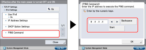

Press [PING Command] for [IPv4 Settings] → enter an IPv4 address that exists on the network → press [Start].
Press [OK] when the result of executing the PING command appears on the touch panel display.
If this result is inappropriate, check the settings described in "Interface Settings," "TCP/IPv4 Settings," and "Settings Common to TCP/IPv4 and TCP/IPv6."
