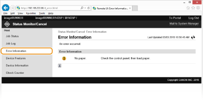

      Checking Error Information
      When an error occurs, this page is displayed by clicking the message displayed under [Error Information] on Portal Page (main page) (Portal Page (main page)). You can also view the error information by following the procedure below.
      Log on to the Remote UI (Starting the Remote UI)  [Status Monitor/Cancel]  [Error Information]

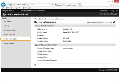

      Checking System Manager Information
      Information about the machine and the System Manager is displayed. You can specify some of the information displayed in this page from the [System Management] page. Setting Up Menu Options from the Remote UI
      Log on to the Remote UI (Starting the Remote UI)  [Status Monitor/Cancel]  [Device Information]
