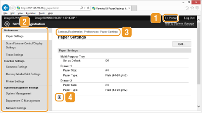

      [Settings/Registration] Page
      [To Portal]
      Returns to Portal Page (main page).
      Menu
      Click an item, and the content is displayed in the right page. Setting Up Menu Options from the Remote UI
      Navigation
      Indicates the series of pages you have opened to display the currently displayed page. You can check what page is currently displayed.
      Top Icon
      Moves the scroll box up to the top of the page when the page is scrolled down.
