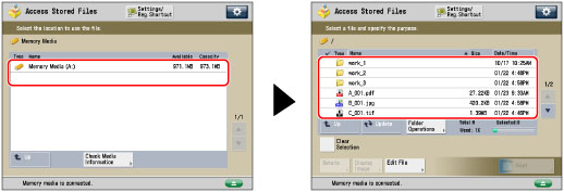

2.
Select the desired memory media → select the destination folder.
