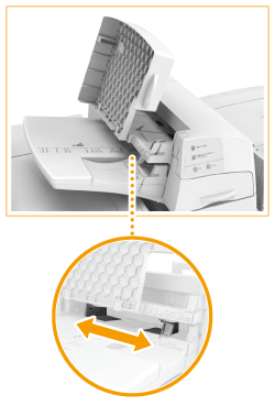

      Adjust the slide guides to fit the paper size.
      To load paper in the upper tray:
      Adjust the slide guide.
      To load paper in the lower tray:
      Open the tray cover.
