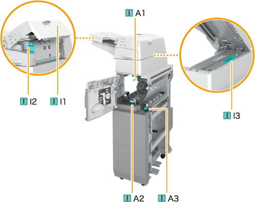

      Check the location of the paper jam on the touch panel display, and follow the procedure described in this section to clear the paper jam. Paper jam locations are indicated by numbers such as I-I1 or I-A1, which are shown in the illustration below. The Document Insertion Unit-N1 is optional. Optional Equipment

      Remove the jammed paper from the upper cover (I-I1) of the document insertion unit.
      Open the upper cover (I-I1) of the document insertion unit.
      Remove the jammed paper.
      3
      Remove the jammed paper from the guide (I-I2).
      Open the guide (I-I2).
      4
      Close the guide (I-I2) and the upper cover (I-I1).
      5

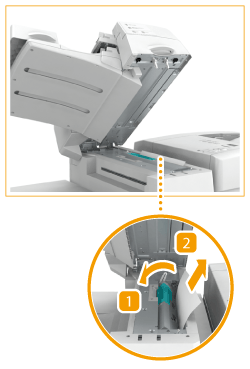

      While pressing the handle lever, open the document insertion unit.
      6
      Remove the jammed paper from the guide (I-I3).
      Open the guide (I-I3).
      7
      Close the guide (I-I3) and the document insertion unit.
      8
      Open the front cover of the document insertion unit.
      9
      Open the guide (I-A1).
      10
      Remove the jammed paper from the guide (I-A1).
      Close the guide (I-A1).
      11
      Open the guide (I-A2).
      12
      Turn the knob (I-A3), and remove the jammed paper.
      Turn the knob (I-A3).
      13
      Close the guide (I-A2) and the front cover.
