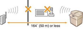

      Check the installation site of the machine and the wireless router.
      Is the machine too far from the wireless router?
      Are there any obstacles such as walls between the machine and the wireless router?
      Are there any appliances such as microwave ovens or digital cordless phones that emit radio waves near the machine?
