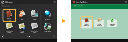

You can register a recipient's fax number or an e-mail address that can be used when sending scanned documents in the Address Book. You can also register an I-fax address and file server folder location (IP address and path) in the Address Book as a destination.
To register a destination for your own use, you need to log in with personal authentication management. Managing Users
<Register Destinations>.
enter the destination name, and press <OK>.
<Rename Address List>).
