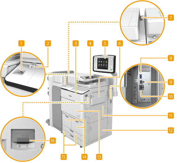

      Front Side
      USB port (Front side)
      You can connect devices such as a USB memory device to the machine. Connecting a USB Memory Device
      NOTE:
      Memory media that does not meet the USB specification is not supported. Some types of memory media may not be able to save data correctly.
      Motion sensor
      When the motion sensor detects a person near the machine, the machine exits sleep mode automatically. Entering Sleep Mode
      Toner replacement cover
      Open this cover when replacing the toner cartridge. Replacing the Toner Cartridge
      Feeder
      Automatically feeds documents into the machine for scanning. When two or more sheets are loaded in the feeder, documents can be scanned continuously. Feeder
      Control panel
      The control panel consists the numeric keys, , indicators, touch panel display, etc. You can perform all the operations and specify settings from the control panel. Control Panel
      Multi-purpose tray
      Load paper into the multi-purpose tray when you want to use a type of paper different from that which is loaded in the paper deck/drawer.
      Glass cleaning sheet storage box
      Use this box to store sheets for cleaning the platen glass.
      USB port (Right side of the main unit)
      You can connect devices such as an external hard disk to the machine. Backing Up/Restoring Data
      USB connector
      Connect a USB cable when connecting the machine and a computer.
      NOTE:
      The USB port of the machine supports USB 2.0.
      LAN port
      Connect a LAN cable when connecting the machine to a wired LAN router, etc. Setting up the Network Environment
      Upper-right cover of the main unit
      Open this cover when clearing a paper jam inside the machine. Paper Jams inside the Right Covers of the Main Unit
      Lower-right cover of the main unit
      Front cover
      Open this cover when clearing a paper jam. Clearing Paper Jams
      Paper deck 1/paper deck 2
      You can load LTR size paper, which is a frequently used size. Paper Deck/Drawer
      Paper drawer 1/paper drawer 2
      Load the type of paper that you frequently use. You can load paper that cannot be loaded in the paper deck, such as LGL and custom size paper. Paper Deck/Drawer
      Power switch
      Press the power switch when turning ON or OFF the machine.
      For more information about the configuration of optional equipment installed on the machine, see Options.
