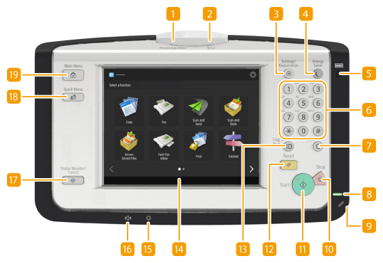

      Upright Control Panel

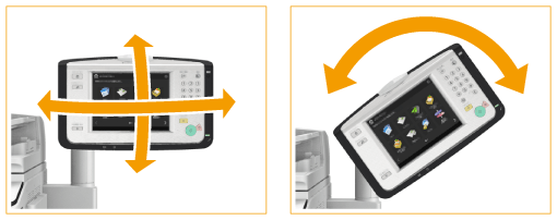

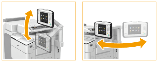

      You can adjust the position and angle of the entire control panel so that the touch panel display can be seen clearly.
      Processing/Data indicator
      Blinks while operations such as sending or printing are being performed. Lights up green when there are documents waiting to be processed.
      Error indicator
      Blinks or lights up when an error such as a paper jam occurs.
      IMPORTANT:
      If the Error indicator blinks, follow the instructions that appear on the touch panel display.
      Clearing Paper Jams
      Clearing Staple Jams
      If the Error indicator maintains a steady red light, contact your local authorized Canon dealer.
      [Settings/Registration] key
      Press to start specifying many of the settings for the machine, such as <Preferences> or <Set Destination>. Settings/Registration
      [Energy Saver] key
      Press to put the machine into sleep mode. The key lights up when the machine is in sleep mode. Entering Sleep Mode
      [Counter/Device Information] key
      Press to display the total number of pages used for operations such as copying or printing on the touch panel display. You can also check the version information of the security chip related to HDD data encryption and other optional device information. Checking the Number of Pages for Copy/Print/Fax/Scan
      Numeric keys ([0] - [9])
      Press to enter numerical values. Entering Characters
      [Clear] key
      Press to clear entered values or characters.
      Main Power indicator
      Lights up when the machine is turned ON. Turning ON the Machine
      Edit pen
      Use the edit pen when operating the touch panel display, such as to enter characters. If you lose the edit pen, contact your local authorized Canon dealer. Do not use an object with a sharp end on the control panel, such as a pencil or ballpoint pen, in place of the edit pen.
      [Stop] key
      Press to cancel copying, faxing, and other operations.
      [Start] key
      Press to start copying or scanning documents.
      [Reset] key
      Press to cancel the settings and restore the previously specified settings.
      ID (Log In/Out) key
      Press this key to log in when personal authentication is necessary. After you finish using the machine, press this key again to log out. Logging into the Machine
      Touch panel display
      In addition to the settings screen for each function, the error status is also shown on this display. Using the Touch Panel Display
      Brightness Adjustment dial
      Use to adjust the brightness of the touch panel display. Using the Touch Panel Display
      Volume Settings key
      Press to display the screen when you want to adjust the sound volume for the fax communication or to set the alarm sound when an error occurs. Setting Sounds
      [Status Monitor/Cancel] key
      Press to check the status of printing or faxing, or to view the usage history. You can also check the status of the machine, such as the remaining amount of paper and toner, or whether any errors occurred. Using the Touch Panel Display
      [Quick Menu] key
      Press to display the functions which are registered in the Quick Menu. Using the Quick Menu
      [Main Menu] key
      Press to display the Main Menu in which buttons for the basic functions are placed. Using the Touch Panel Display
      Adjusting the Position and Angle of the Touch Panel Display

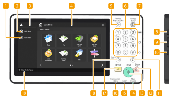

      Flat Control Panel
      <Quick Menu>
      <Main Menu>
      Login user name
      The user name that is currently logged in is displayed.
      Touch panel display
      [Energy Saver] key
      Brightness Adjustment key
      Volume Settings key
      [Clear] key
      [Stop] key
      [Start] key
      Error indicator
      IMPORTANT:
      Clearing Paper Jams
      [Reset] key
      ID (Log In/Out) key
      <Status Monitor/Cancel>
