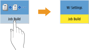

Selecting a Button
When you press a button, the button color may change or a check mark may be added to indicate that it has been selected.
Press the function setting button to display the setting status in the upper section of a button and the color of the lower section is changed.
Press a button in which is located in the lower-right to display the setting screen. When the setting is made, the setting status is displayed in the upper section of the button and the color of lower section is changed.

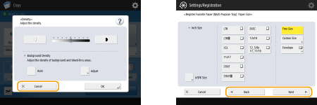

Press <OK> to apply settings and press <Cancel Settings> to discard the changes and restore the previous settings.
In addition, buttons such as <Cancel> which cancels the setting and returns to the previous screen, <Next> which applies the setting to proceed to the next screen, <Back> which returns to the previous setting screen and <Close> which closes the screen currently open are displayed.

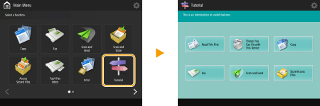

Press <Tutorial> on the Main Menu to display a screen that introduces what you can do with the functions of the machine as well as tips for using copy, scan, etc. View this screen when you want to learn more about what functions are available and how to use them.
Example: Tutorial for Copy functions
When you select an item from the list, the tutorial screen is displayed.

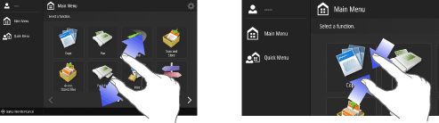

Operate in the same manner as with a smartphone (flick/pinch)
On some screens such as the Main Menu and the Quick Menu, you can switch the page or scroll by flicking your finger up/down or left/right on the screen as you would with a smartphone.
You can also zoom in or out on the screen by using two fingers to pinch out or pinch in. You can drag the enlarged screen with your finger. Configuring Accessibility Settings (Personal Settings)
