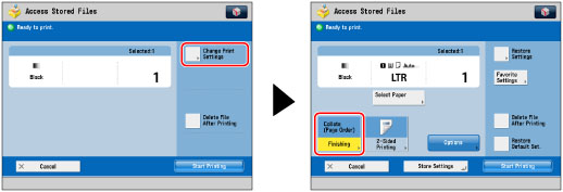

Specifying the Finishing Mode
1.
Press [Access Stored Files] → [Mail Box].
2.
Select the desired Mail Box → select the desired file → press [Print].
3.
Press [Change Print Settings] → [Finishing].
To change the paper source, see "Paper Selection."
4.
Set the desired finishing mode.
