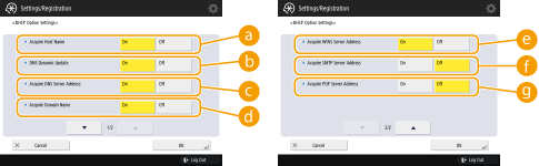

Using a DHCP Server
You can acquire a host name by using the DHCP server.
1
Press .
2
Press <Preferences> <Network> <TCP/IP Settings> <IPv4 Settings> or <IPv6 Settings> <DHCP Option Settings>.
3
Carry out the necessary setup.
Some items may not be displayed in <IPv6 Settings>.
<Acquire Host Name>
To acquire a host name through the DHCP server, press <On>.
<DNS Dynamic Update>
To make the DHCP server automatically update information regarding correspondence between the IP addresses and the host names without using the machine, press <On>.
<Acquire DNS Server Address>
To acquire the DHCP server IP address, press <On>.
<Acquire Domain Name>
To acquire a domain name through the DHCP server, press <On>.
<Acquire WINS Server Address>
To acquire a domain name through the WINS server, press <On>.
<Acquire SMTP Server Address>
To acquire a domain name through the SMTP server, press <On>.
<Acquire POP Server Address>
To acquire a domain name through the POP server, press <On>.
4
Press <OK>.
5
Press     <Apply Setting Changes> <Yes>.
