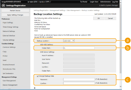

When backing up to an external hard disk
[Backup Location]
Select [USB HDD].
[Folder Path]
Enter the path to the folder on the external hard disk in which to save the backed-up data.
[Encrypt Backup Data]
If you select the check box and enter a password, you can encrypt the backed-up data. The password specified here will be required when restoring the encrypted backup data.
When backing up to an SMB server
[Backup Location]
Select [SMB Server].
[Host IP Address]
Specify the location of the SMB server. Use the following format: \\Name of server\Name of shared folder
[User Name]
Enter the user name for accessing the SMB server.
[Password]/[Confirm]
Enter the password for accessing the SMB server. For confirmation, enter the same password again in [Confirm].
[Folder Path]
If the backup folder is at a level below , add the rest of the path that follows . Make sure that the user limit of the specified folder is set to allow two or more users. If the user limit is set to allow one user, you will not be able to restore the backed-up data properly.

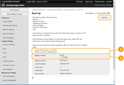

Select the backup method, and click [Execute]  [OK].
[Backup Data Capacity]/[Backup Location Available Space]
If [Backup Location Available Space] is not enough for [Backup Data Capacity], set a different backup destination.
[Backup Method]
Select [All] to perform standard backup. If you only want to back up the data that has been changed since the previous backup, select [Changes].
Backup can be performed a limited number of times in the same folder. If backup can no longer be performed, specify a different backup destination folder.
[Changes] for Advanced Box backs up only the data updated or added since all the stored data was backed up. [Changes] always backs up data based on differences from [All] as opposed to the last [Changes] backup.
