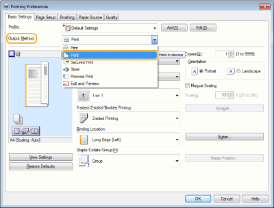

Open a document and display the print screen.
For information on displaying the print screen, see Help of each application.
2
Select the machine and click [Properties].
3
Select [Hold] at [Output Method].
4
Change the print settings as necessary and click [OK].
5
Click [Print] or [OK].
The document is sent to the Job Hold saving area.

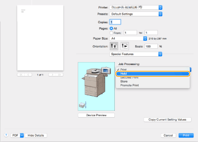

1
2
Select the machine.
3
Specify the print settings as necessary and click [OK].
4
Select [Hold] at [Job Processing] of the [Special Features] panel.
5
Click [Print].
6
Click [OK].
