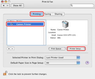

Mac OS X 10.4.x
1.
Open [System Preferences] → click [Print & Fax].
2.
Click [Printing] → select your printer → click [Printer Setup].
3.
Select [Installable Options] → configure the options installed in the printer → click [Apply Changes].

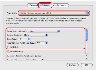

Mac OS X 10.5 and later
1.
2.
Select the printer you are using → click [Options & Supplies].
3.
Click [Driver] → confirm that your printer is selected for [Print Using] → configure the options installed in the printer.
IMPORTANT
Be sure to select only those options that are actually installed in the printer.
4.
Click [OK].
