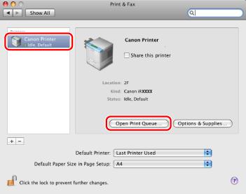

1.
Open [System Preferences] → click [Print & Fax].
2.
Select your printer → click [Open Print Queue] (or [Print Queue]).

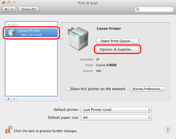

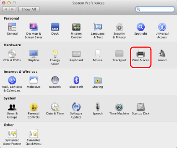

1.
Open [System Preferences] → click [Print & Scan] (or [Print & Fax]).
2.
Select your printer → click [Options & Supplies].
