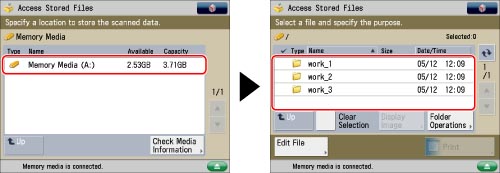

Press [Access Stored Files] → [Memory Media].
2.
Select the desired memory media → select the location where the file you want to print is stored.
3.
Slect the desired file → press [Print].
