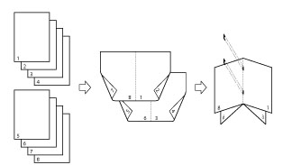

The Saddle Stitch mode is available only if the Booklet Finisher-M1 is attached.
The maximum numbers of sheets, including cover sheets, that can be saddle stitched are described below.
11 to 16 sheets of paper (17 to 21 lb bond (64 to 82 g/m2))
6 to 10 sheets of paper (22 to 28 lb bond (83 to 105 g/m2))
1 to 5 sheets of paper (29 to 32 lb bond (106 to 120 g/m2))
The accuracy of folds created in the Saddle Stitch mode may vary depending on the paper type and the number of sheets
Make sure to adjust the Booklet Tray guide to match the size of the output paper before outputting saddle stitched prints, as shown below.
The Saddle Fold mode is available only if the Booklet Finisher-M1 is attached.
The paper is saddle folded one sheet at a time, and then output.
