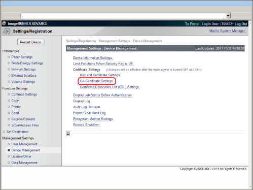

1.
Click [Settings/Registration] → [Device Management] for <Management Settings>.
2.
Click [CA Certificate Settings] → [Register CA Certificate] → [Install...].
3.
Click [Browse].
4.
In the dialog box that appears, select the CA certificate file to install → click [Open...].
The maximum number of characters that you can enter for the file name in [File Path] is eight, excluding the file extension ".cer". Specify the name of the file to install so that it will not exceed eight characters.
5.
Click [Start Installation].

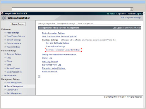

1.
2.
Click [Certificate Revocation List (CRL) Settings].
To register a certificate revocation list (CRL):
To check a certificate revocation list (CRL):
To delete a certificate revocation list (CRL):
Click [Register CRL...] → [Browse].
Select the certificate revocation list (CRL) you want to register.
Click [Register].
IMPORTANT
A certificate revocation list (CRL) cannot be registered in the following cases:
If you want to register more than 50 certificate revocation lists (CRL)
If the file size of a certificate revocation list (CRL) is more than 1MB
If you use the unsupported signature algorithm
If more than 1,000 expired certifications are registered in a certificate revocation lists (CRL)
Click the certificate revocation list (CRL) you want to check → click [Verify CRL].
Check the certificate revocation list (CRL) you want to delete → click [Delete].

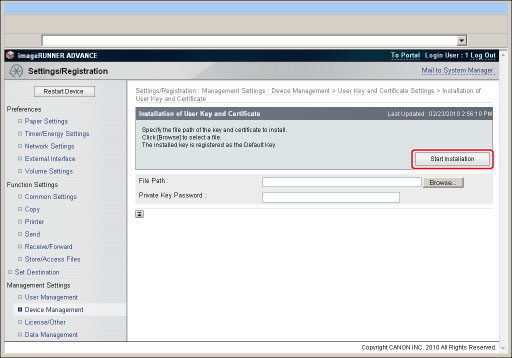

1.
2.
Click [User Key and Certificate Settings].
If an administrator is logged in, all of the registered user key pair files and certificate files are displayed.
If a general user has logged in, only their user key files and certificate files are displayed.
To install a user key and certificate:
To check/erase a user key pair file:
Click [Install...] → enter the path for the key pair and certificate file to install and the password of the private key → click [Start Installation].
The maximum number of characters that you can enter for the file name is twenty, excluding the file path and file extension ".p12" or ".pfx". Specify the name of the file to install so that it will not exceed twenty characters.
IMPORTANT
Up to 100 user certificate files can be installed, with a maximum of one user certificate per user. An error is displayed after you press [Start Installation], if you attempt to install more than 100 certificate files, or more than one user certificate file for a user.
