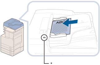

(Start). The machine automatically feeds the originals to the platen glass and scans them. Two-sided originals can also be automatically turned over and scanned as two-sided documents.
(Start). The machine automatically feeds the originals to the platen glass and scans them. Two-sided originals can also be automatically turned over and scanned as two-sided documents.|
IMPORTANT
Thin originals may become creased, if used in a high temperature or high humidity environment.
Do not place the following types of originals into the feeder:
Originals with tears or large binding holes
Severely curled originals or originals with sharp folds
Clipped or stapled originals
Carbon backed paper or other originals which may not feed smoothly
Transparencies and other highly transparent objects
Always smooth out any folds in your originals before placing them into the feeder.

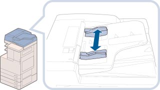

CAUTION |
Do not insert your hands in the gap in the original supply tray, as doing so may cause injury.
IMPORTANT
Do not drop clips or other objects into the gap in the original supply tray.
Do not add or remove originals while they are being scanned.
When scanning is complete, remove the originals from the original output area to avoid paper jams.
Do not place items in the original output area, as doing so may cause damage to your originals.
When you are enlarging an LTR or STMT original onto 11" x 17" or LGL paper, place the original horizontally.
The scanned originals are output to the original output area in the order they are fed into the feeder.
