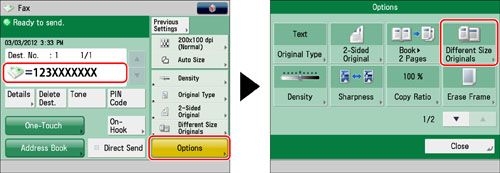

1.
Press [Fax].
2.
Specify the destination → press [Options] → [Different Size Originals].
3.
Select the type of originals → press [OK] →[Close].
[Same Width]:
Press this key if you are placing originals with the same width.
[Different Width]:
Press this key if you are placing originals with different widths.
