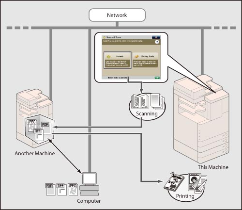

You can save originals scanned from the machine to the Advanced Box of another imageRUNNER ADVANCE series machine that is opened externally on the network. You can also recall files saved to an Advanced Box on the network and print them from the machine.
Benefits of Using a Network
File sharing environment available without installing a server
A network location refers to the Advanced Box of another imageRUNNER ADVANCE series machine on the network that can be accessed by this machine. You can use the network to enable easy file sharing.
Document management using generic data formats
You can perform document management by converting document data scanned with the machine into file formats (PDF, XPS, JPEG, TIFF, or OOXML) that can be used on a computer.

This section describes the procedure for scanning a document, saving it to an Advanced Box open on the network using SMB, and then printing the data from the Advanced Box.
Follow the procedures below.
