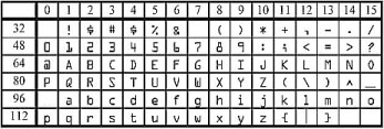

OCR-A and OCR-B Fonts
The following PCL escape sequences enable OCR-A and OCR-B fonts:
OCR-A:
<Esc>(0O<Esc>(sp10h12vsb104T
OCR-B:
<Esc>(1O<Esc>(sp10h12vsb110T
The above table shows the OCR-A character set.
