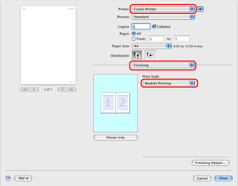

You can print two pages of a document on each side of each sheet, then fold the sheets in half to create a booklet.
With booklet printing, the print order is adjusted so that the pages are output with the page numbers in the correct order, and a booklet can be created by simply folding the three output pages in half.
1.
Select [Print] from the [File] menu of the application.
2.
Select your printer → [Finishing] → [Booklet Printing] from [Print Style].
3.
Specify the settings for booklet printing → click [Print].
You can specify the following settings:
[Booklet]: Opens a dialog box that enables you to set creep (displacement) correction.
[Saddle Stitch Setting]: Applies saddle stitching (stapling through the center of the pages) to the booklet.
The available settings for booklet printing differ depending on the printer model you are using and attached options.
You cannot specify the [Finishing] options in the [Finishing] preferences pane when performing Booklet Printing.
The display may vary according to the operating system, as well as the type and version of the printer driver.
