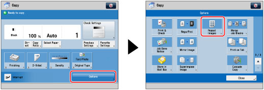

1.
Press [Copy].
2.
Press [Options] → [Repeat Images].
