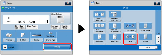

1.
Press [Copy].
2.
Press [Options] → [Shift].
3.
Press [By Position].
4.
Select the shift direction → press [OK] → [Close].

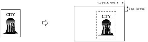

Using the Numeric Keys:
You can shift the entire original to a position that you specify using - (numeric keys). You can also select the shift direction for the front and back sides of documents separately.
1.
Press [Copy].
2.
3.
Press [By Numeric Keys] → <Front Side> or <Back Side> for [Set].
If you select [Same as Front Side] for <Back Side>, the setting specified for <Front Side> is used. If you select [Opposite to Front Side], the left and right values set for the front side are reversed for the back side.
4.
Use - (numeric keys) to enter the shift position.
Select the shift direction.
Enter the shift value.
Press [OK].
To change a value you entered, select the shift direction → enter the correct value using - (numeric keys).
The values for the back side can also be automatically set by selecting [Same as Front Side] or [Opposite to Front Side].
Examples: When the front side is set to 1 15/16" (50 mm) for the left, and 4" (100 mm) for the top.
If you select [Same as Front Side]: 1 15/16" (50 mm) for the left, and 4" (100 mm) for the top
If you select [Opposite to Front Side]: 1 15/16" (50 mm) for the right, and 4" (100 mm) for the top
Example: To move the original image in a diagonal direction:
Press the top .
Enter '3/8' using the numeric keys.
Press the right .
Enter '5/8' using the numeric keys.
5.
Press [OK] → [Close].
