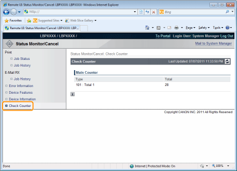

Checking the Counter Using a Web Browser (Remote UI)
You can check the number of the printed pages using the Remote UI.
1
Start the Remote UI, and then log in as Administrator.
2
Select [Check Counter] from the [Status Monitor/Cancel] menu.
3
Check the number of the printed pages.
