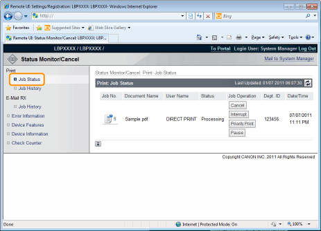

Checking/Deleting the Job Currently Being Printed
1
Start the Remote UI.
2
From the [Status Monitor/Cancel] menu, select [Job Status] to display the job currently being printed.
3
If you want to delete the job, perform the following procedure.
Using job operation, click [Cancel] on the job you want to delete.

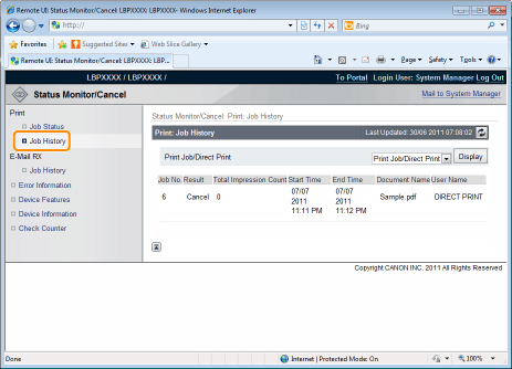

Checking Job History
1
2
Select [Job History] from the [Status Monitor/Cancel] menu.
3
Select the options that you want to display.
[Print Job/Direct Print]:
The printed job history is displayed from the computer.
[Stored Job]:
The printing history of jobs stored in BOX is displayed.
[Report]:
The utility print printing history is displayed.
[E-Mail Print]:
The history of jobs received by e-mail and printed is displayed.
