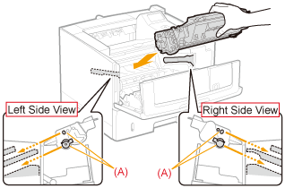

Keep the protective bag. Do not discard it. You will need it when you remove the toner cartridge for printer maintenance or other purposes.
IMPORTANT
Precautions when pulling out the sealing tape
Do not pull the sealing tape diagonally, upward, or downward. If the tape is severed, this may become difficult to pull out completely.
![]() If the sealing tape stops at midpoint, pull it out of the toner cartridge completely. If any tape remains in the toner cartridge, this may result in poor print quality.
Dispose of the removed sealing tape according to local regulations.
If you cannot close the front coverMake sure that the toner cartridge is installed in the printer properly. Do not try to forcefully close the front cover, as this may damage the printer.
(1)
Remove the tape, and fold the protrusions of the packing material on each side.
(2)
While holding the lock release levers (A), slide the paper guides in the directions of the arrows.
(3)
Remove the packing material.
