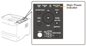

<Question 1> Is the printer turned ON?
Check if the Main Power indicator on the control panel is turned on.
ON
To <Question 2>
OFF
Turn the printer ON.
Cannot be turned ON

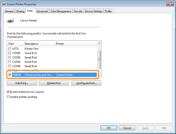

<Question 8> Is the port to be used selected correctly?
Selected
To <Question 9>
Not selected
Select the correct port.
The port to be used cannot be found.
Install the printer driver again.

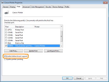

<Question 9> Is bi-directional communication enabled?
Enabled
To <Question 10>
Not enabled
Enable bi-directional communication and restart the computer and printer.
