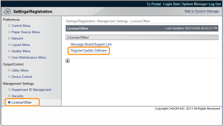

1
Start the Remote UI, and then log in as Administrator.
2
From the top page of the Remote UI, click [Settings/Registration] → [License/Other] → [Register/Update Software].

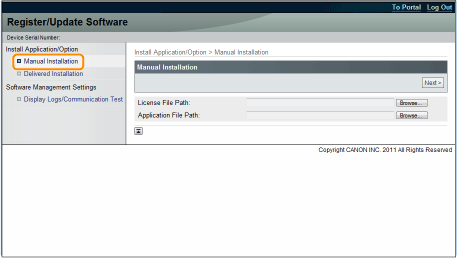

3
Click [Manual Installation].
4
Click [Browse...] → select the license file to install → click [Next].

1
2
3
4
Click [Browse...] → select the license file and the application file to install → click [Next].

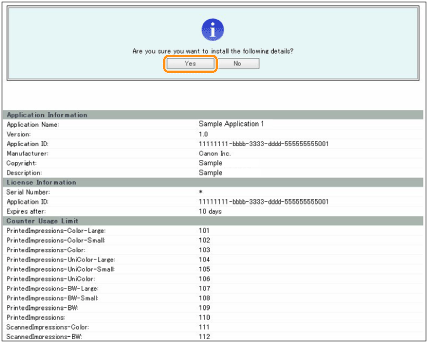

5
Confirm the information displayed on the install confirmation page → click [Yes].
Depending on the MEAP application, a software license agreement screen may be displayed. Confirm the information displayed on the screen → click [OK].
If you are installing a new MEAP application, the following information is displayed on the screen.
Application Information
License Information
The following information is displayed when you overwrite a MEAP application.
Current Application Information
Application Information after Overwrite
Installation will start after the message <Installing... Please wait.> is displayed again. After the installation, click [To Manual Installation] to display the Manual Installation screen.

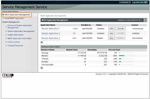

Starting the MEAP Applications
This section describes how to start the installed MEAP application from the SMS screen.
Details on SMS
For details on SMS, see "MEAP ."
1
From the top page of the SMS, click [MEAP Application Management].
2
Select the application you want to start → click [Start].
