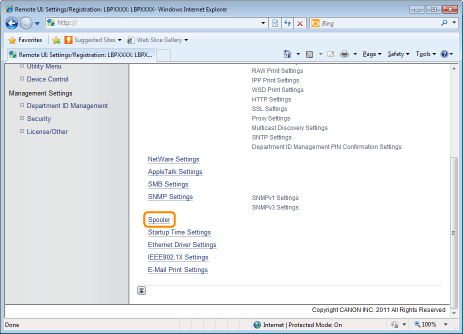

Select [Network] from the [Preferences] menu.
4
Click [Spooler].

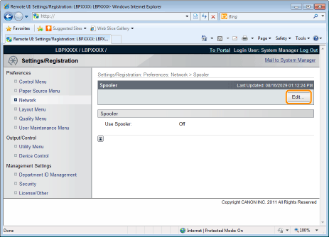

5
Click [Edit...].

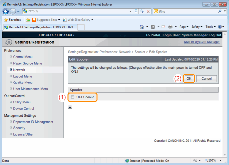

6
Specify the setting for the spooler function.
(1)
When using the spooling function, select the [Use Spooler] check box.
(2)
Click [OK].
