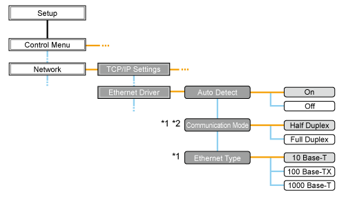

When configuring the interface using the printer's control panel, use the following menu hierarchy.
*1
[Communication Mode] and [Ethernet Type] are displayed when [Auto Detect] is set to [Off].
*2
[Communication Mode] appears only when [Ethernet Type] is set to a setting other than [1000 Base-T].

Configure the Ethernet driver.
This printer can detect the communication method and Ethernet type automatically. Normally, set [Auto Detect] to [On].
If you want to fix the communication method and Ethernet type, set [Auto Detect] to [Off].
If you are using a hub, match the settings for the hub and the printer.
When detecting the Ethernet driver automatically (Default)
(1)
Select [Auto Detect] using [ ] and [  ], and then press [OK].
(2)
Select [On] using [ ] and [  ], and then press [OK].
When detecting the Ethernet driver manually
(1)
(2)
Select [Off] using [ ] and [  ], and then press [OK].
(3)
Select [Communication Mode] using [ ] and [  ], and then press [OK].
(4)
Select an Ethernet communication method appropriate for your network environment using [ ] and [  ], and then press [OK].
[Half Duplex]:
Receives and transmits data alternately, not simultaneously.
[Full Duplex]:
Receives and transmits data simultaneously.
(5)
Select [Ethernet Type] using [ ] and [  ], and then press [OK].
(6)
Select an Ethernet type appropriate for your network environment using [ ] and [  ], and then press [OK].
