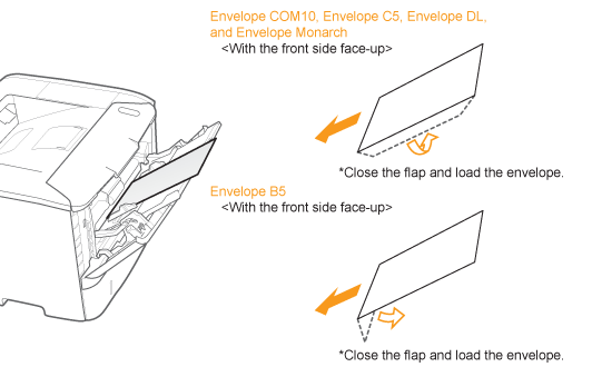

Loading envelopes
You can load envelopes only in the multi-purpose tray.
<Precautions when loading envelopes>
Load envelopes in the correct orientation as follows.
(: Feeding direction)
Before loading envelopes, align them as follows.
1.
Place the stack of envelopes on a flat surface, and then flatten them to release any remaining air.
Then, press the edges tightly.
2.
Loosen any stiff corners of the envelopes and flatten curls as shown in the figure.
3.
Align the edges of the envelopes on a flat surface.
