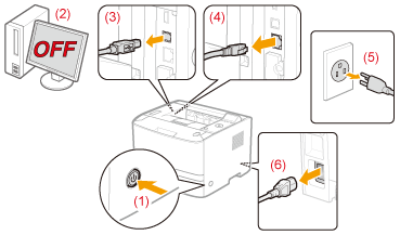

Turn the printer OFF, and then disconnect the cables or cords from the printer.
Shut down the printer before turning it OFF.
For details on the procedure for shutting down the printer, see "Turning the Printer ON/OFF."
<How to disconnect the cable or cord>
USB cable*
(2) Turn the computer OFF.
(3) Disconnect the cable from the printer.
LAN cable*
(4) Disconnect the cable from the printer.
Power cord
(5) Disconnect the power plug from the AC power outlet.
(6) Disconnect the cord from the printer.
