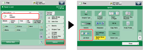

Press (Main Menu) → [Fax].
2.
Specify the destination → press [Options] → [Job Build].
3.
Press [Close].
4.
Press (Start).
