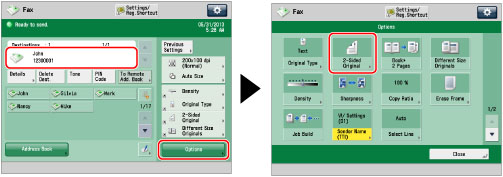

1.
Press (Main Menu) → [Fax].
2.
Specify the destination → press [Options] → [2-Sided Original].
3.
Select the type of two-sided original → press [OK] → [Close].
[Book Type]:
The front and back sides of the original have the same top-bottom orientation.
[Calendar Type]:
The front and back sides of the original have opposite top-bottom orientations.
