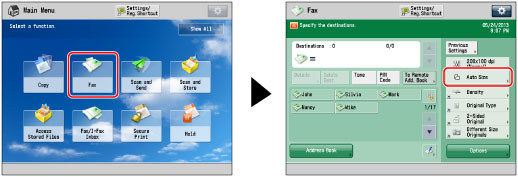

(Main Menu) → [Fax] → specify the desired destinations → press the scan size button.
