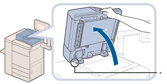

1.
Open the feeder.
* Sensor
IMPORTANT
This machine is equipped with an open/close sensor of the feeder (see circled area in the above illustration). When placing originals on the platen glass, lift the feeder approximately 11 7/8" (300 mm) so that the sensor detaches from the feeder. If the sensor does not detach from the feeder, the size of the originals may not be detected correctly.

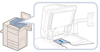

2.
Place your originals face down.
The surface of the original that you want to copy must be placed face down. Align the top edge of your original with the back edge of the platen glass (by the arrow in the top left corner).
Place books and other bound originals on the platen glass in the same way.
When you are enlarging an LTR or STMT original onto 11" x 17" or LGL paper, place the original horizontally on the platen glass, and align it with the LTRR or STMTR marks.
