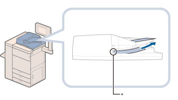

If the scanned originals in the output tray are detected when you place originals into the Duplex Color Image Reader Unit-H1, the Original Output Indicator blinks for a certain time. In this case, remove the scanned originals left in the original output tray to avoid paper jams.
* Original Output Indicator

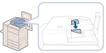

Do not insert your hands in the gap in the original supply tray, as doing so may cause injury.
IMPORTANT
Do not drop clips or other objects into the gap in the original supply tray.

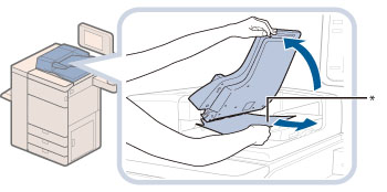

When scanning is complete, remove the originals from the original output area to avoid paper jams. (When you use the Duplex Color Image Reader Unit-H1, the Original Output Indicator blinks for a certain time when scanning is complete.)
* Original Output Area
Do not place items in the original output area, as doing so may cause damage to your originals.
