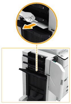

      5
      Remove the jammed paper.
      Close the upper escape guide.

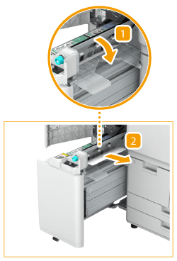

      1
      Open the front cover of the finisher.
      2
      Pull out the saddle stitcher unit.
      Turn the knob at the top of the saddle stitcher unit about 10 times.
      3
      Open the transparent guide.
      Close the transparent guide.
