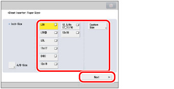

4.
Select the desired paper size → press [Next].
IMPORTANT
Select the same paper size that is loaded in the Document Insertion Unit-H1.
To select an A or B series paper size, press [A/B Size].
