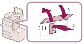

3.
Turn ON the main power.
1. Open the main power switch cover.
2. Press the main power switch to the "I" side.
3. Close the main power switch cover.
The main power indicator on the control panel lights when you turn ON the main power switch.
Various screens appear when system software is loading.
If you are using a login service, log in using the procedure for the login service you are using.
You can change the default display that appears after the machine is turned ON from [Default Screen after Startup/Restoration] on the Settings/Registration screen. (See "Default Screen after Startup/Restoration.")

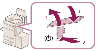

Shutting Down the Machine
This machine performs a procedure to protect the hard disk when the machine is shut down.
This enables the machine to be shut down safely, even if there are any jobs being processed, or a MEAP application is running while the machine is shutting down.
1.
Turn OFF the main power.
2. Press the main power switch to the "" side.
IMPORTANT
Do not turn the main power OFF while using the Fax/I-Fax function. Sending or receiving I-fax or fax documents cannot be done when the main power is turned OFF.
If the message <Backing up stored data from the Remote UI...> is displayed on the touch panel display, do not turn the main power OFF. This may cause the machine to fail to back up the stored data.
Data stored in the machine may be damaged if the Advanced Box is accessed by another imageRUNNER ADVANCE machine or a computer immediately before the machine shuts down.
The machine may take some time to completely shutdown. Do not unplug the power cord until the main power indicator of the machine is OFF.
If the main power is turned OFF during scanning or printing, a paper jam may occur.
If you set [Quick Startup Settings for Main Power] to 'On' in [Preferences] (Settings/Registration), the tone sounds when turning OFF the main power of the machine. (Depending on the situations, the machine does not startup quickly and the tone does not sound.)
